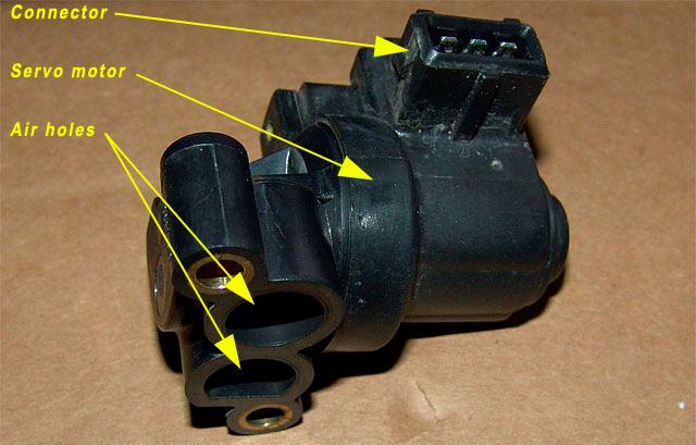

Well, the part we will work with is a small air servo motor sensor (see image
above) that controls some of the air going
in to the engine. It even controls the engine idle speed compared to, for example,
the climate control system.
The air servo motor sensor will compensate for loss of power when AC is turned
on, meaning more "unvisible throttle
action". This, however, was not noticed to change because of this modification.
The air servo motor can open from
0% to 100%, and when the car is started when engine is cold, then the air servo
motor open to around 100%, and
that is the idle around 1600 - 2100 RPM, depending on different engines, models
and year make. You will not
destroy your engine, get any error codes etc. etc. You will have a smoother
running engine at around 1100 RPM in
cold idle and a car with better fuel economy!

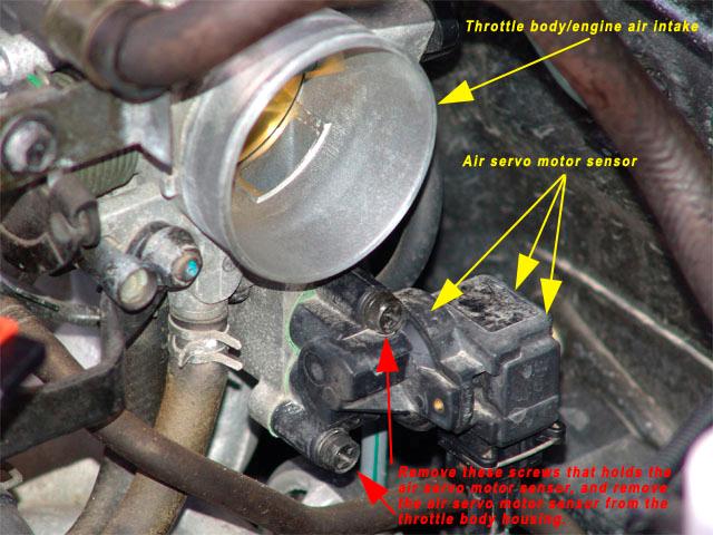

FIRST! Remove the engine plastic top cover!
1. Remove the air hose running from the air filter box to the MAF sensor (or
just the filter and the MAF if modded)
2. Remove the MAF sensor

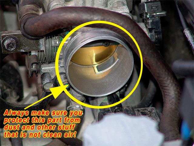

3. Remove the small hose on remaining air hose still connected to the throttle
body
4. Remove the air hose fitted onto the throttle body.
5. IMPORTANT! Cover the throttle body air intake with tape or a plastic bag
to be sure no dirt will go in there!
6. Remove the air servo motor sensor with screwdriver (see picture above)

9. You should now see the two large holes that handles the air flow, that the
servo motor controls (se picture below).

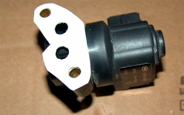

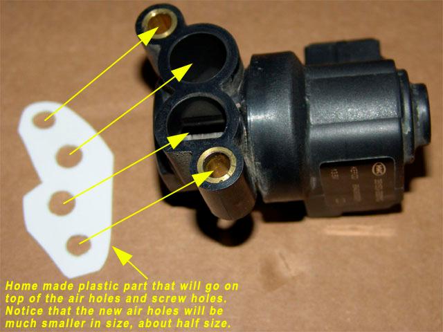

10. Put some metalic tape, or something else, over all holes and push it down
so that you get the shape of all...
.....holes and the outer line. This way you can make a part in plastic or metallic
that will fit on top of the holes.
11. Cut/build the new part that will have half size smaller holes than seen
on the air servo motor sensor, I used...
......a soft plastic piece because it will allow itself to be pressed together
a bit, this means air tight (see below)

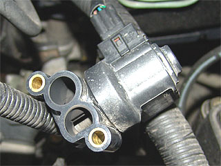

12. Now install the new part you've made (see image below)
13. Insert the screws, re-install the air servo motor sensor and re-install
all other parts you've removed.
