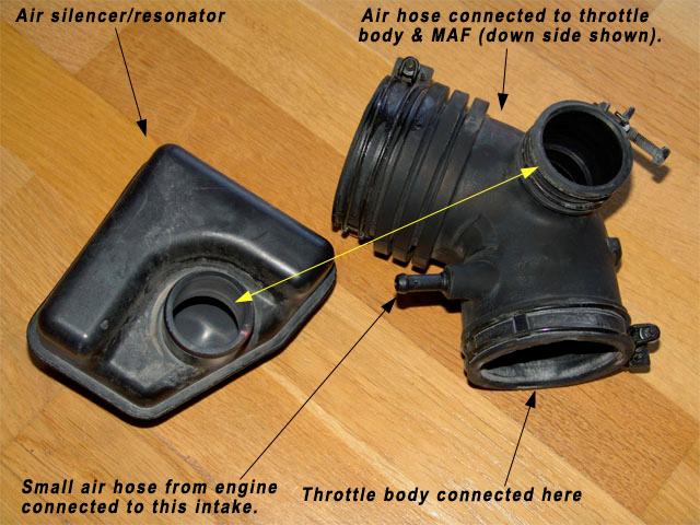

Air silencer/resonator
This part of the air modification I've done is also important. The
air silencer was installed to take
away some of the noice from the air intake on the throttle body. When you push
the pedal to the metal
you open the throttle body for full air flow, and the sound that comes from
the engine is the sound
that engineers want to damp down. BUT, this WILL rob your engine on power and
make your car drink
more fuel. The air silencer is just a small plastic box with nothing in it,
and the air flow will be very
disturbed on its way to the throttle body. GET RID OF IT!!! (more pictures below)

4. Remove the air hose fitted onto the throttle body (this part has the air
silencer on the bottom of it)

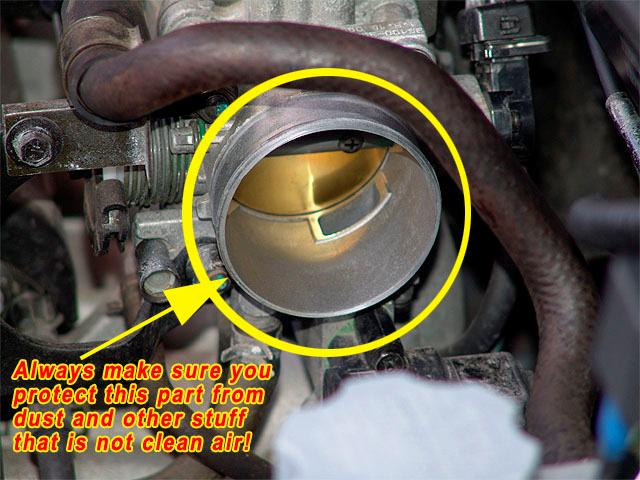

5. IMPORTANT! Cover the throttle body air intake with tape or a plastic bag
to be sure no dirt will go in there!

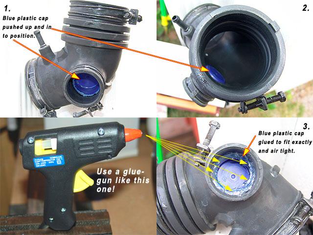

6. Remove the air silencer box
7. As the pictures below show, install any plastic part that fits in the hole
where the silencer was fitted.
8. Make sure there is a smooth surface inside the air hose where the plastic
part is installed.
9. With a gluegun, make sure there is glue in any open spaces around the part
you just installed.

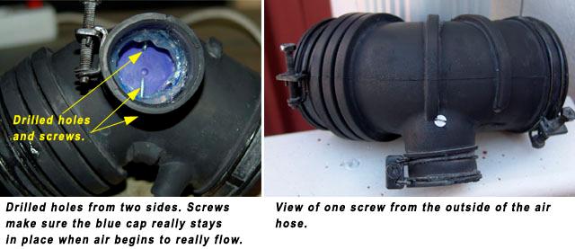

10. Drill and put two screws into the plastic part you just installed. This
is to be sure the plastic part will stay there!
11. Re-install everything!
