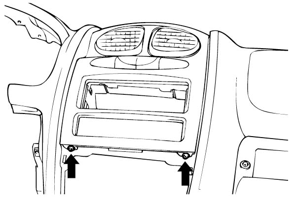

Too remove the lower
fascia panel; here is how: 1. remove the ashtray 2.
remove the 2 screws as the ashtray holder
(Click on image to open up in full size)
![](../../images/CenterFacia/CenterFacia1.jpg) 3. push the
lower panel (under ashtray) down with strength and then
pull the lower panel out with strength also.

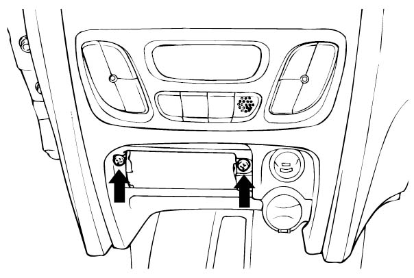

remove upper fascia panel: 1. remove lower
panel first as list above 2. remove 2 screws under
the stereo panel when lower panel is out then you will
see that 2 screws
![](../../images/CenterFacia/CenterFacia2.jpg) 3. pull the upper panel out with
strength as well.
wales1 Registered User Posts:
112 (6/30/01 8:11
am) |
Re: Removing center
fascia panel
you need to pull with some force, but pull straight out
towards you. grip the panel from in the ash tray holder.
Remember, its plastic, so use some care, and the
tabs are not the thickest I have see, so watch out.

Thanks for the replies. "With force" is the key
phrase.
